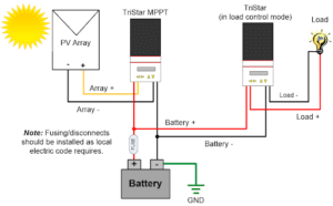

Tristar solar energy system diagram with two loads
